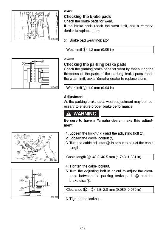

rightarm
SnoWarrior said:It's easy, did mine yesterday. Here are instructions from the owners manual.
I see someone has a manual
Nice!rx1mtn
