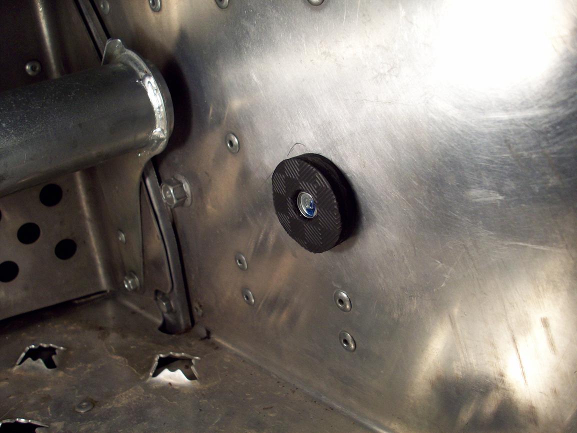

I discovered last weekend when riding that my boots had worn a hole thru the outer layer due to the rear suspension front mounting bolt. How did I find out, foot started to get cold and when I got back to our place I poured around 8 oz of water out out of my right boot.
I did notice a little wear on the insides of my Klim boots prior, didn't pay it much attention until then. Anyone else have this problem yet?
I picked up some grip disc from the local hardware store, stacked them and drilled out the center hole and mounted them. Plan on calling Yamaha tomorrow for a couple other things, I'll bring this up. It's really a simple fix for them, use a button head bolt...problem solved...

Good idea!Yes I noticed some wear on my boots.Those stirrups will shred a cover or your pants also if sharp edge is smoothed out.

Yea had the same thing happen to me, I ended up finding a allen head bolt that was smooth and tapered and replaced the bolt with that one. It still wears on my boots, but not as bad.

osceolacabin said:I discovered last weekend when riding that my boots had worn a hole thru the outer layer due to the rear suspension front mounting bolt. How did I find out, foot started to get cold and when I got back to our place I poured around 8 oz of water out out of my right boot.
I picked up some grip disc from the local hardware store, stacked them and drilled out the center hole and mounted them. Plan on calling Yamaha tomorrow for a couple other things, I'll bring this up. It's really a simple fix for them, use a button head bolt...problem solved...![]()
excellent idea
