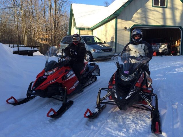

Rt. Viper LTX DX stock mid height windshield, Lt. Viper LTX SE with high windshield. When and if you ride long distance, 100+ miles between stops, there is a tremendous difference in comfort level compared to the low sport windshield delivered on the SE. Only get harassment once, until they see or feel the difference in windscreens. If you ride shorter distances between stops not an issue with short windscreen.
Mid height clear windshield will give him more protection and allow better vision for him. Something to think about.
