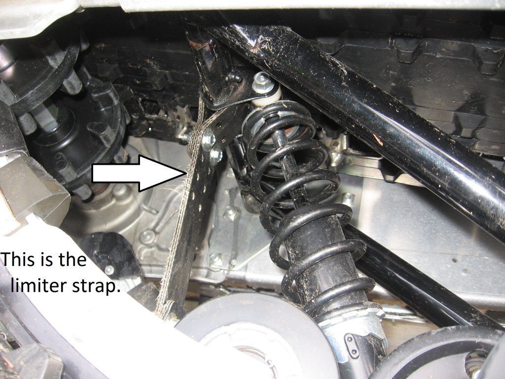

-Do you know what position your limiter strap is in, or have someone familiar with snowmobile suspensions (if you are not) able to take a look and give you this info.?

The limiter strap is in the suspension of your track. It looks like a piece of belting.

Set ur strap in middle.

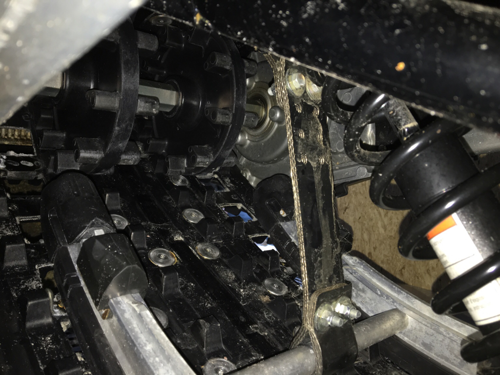

Today I will get into suspension adjustment. Any tips for settings? Strap is in hole 2. I'm 120lb and primarily trail ride. Here are some photos I took...

Wow! was that the Ski Spindle ? That was bent? , So While you have it off the ground loosen those springs on the front shocks until you can slide the spring up and down just a little . Then tighten the locking one or two turns to keep the springs seated. Your limiter strap looks all the way lose. tighten it up one hole. The shims under the ski rubbers goes in the back of the rubber not the front . There is a nice writeup on Hard Core Sledder under the Polaris section. It's a good read and will show you what to do for shims. I make mine out of rubber belting but many use pc's of Hyfax cut at an angle . Most people have some left over from cutting off the ends of there slides. The shim only needs to be about a 1" to 1.5" wide and the full width of the ski rubber.
Woody's Slim Jim Dooley's are a crowd favorite. and might be cheaper Then Snow trackers. I'm running the Semi Aggressive Snow tracker's on my Vector and It's the Best Carbide I have tried so far. They are pricey. If you look on Ebay you might find a deal for Them .
Do a search on Aligning you ski's ... Very important ! most every Carbide except the Snow Trackers require you skis to be toed out . I prefer about a 1/4" toe out on each ski.
It does help to move the shim on the ski bolt to widen the stance.
If the steering become heavier with all of these adjustments tighten the spring collar on the front shock by the limiter strap! one or two turns . It will lighted up the steering!
