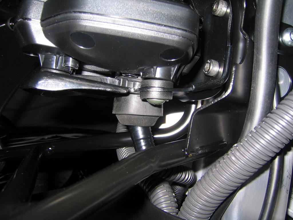

Just in case anyone has turned the bracket upside down
and remounted the POD you will find that the cables and
wires need a little adjusting and the last thing is the rubber
boot on the POD plugin. What i done was installed a electrical
tie between the Pod & Bracket and pulled it tight and this keeps
the boot in place and it cannot slip off as it bring up in the tie.
You'll know what i'm talking about if you don't do this, i'll try
and post a pic but it might be hard to see.
