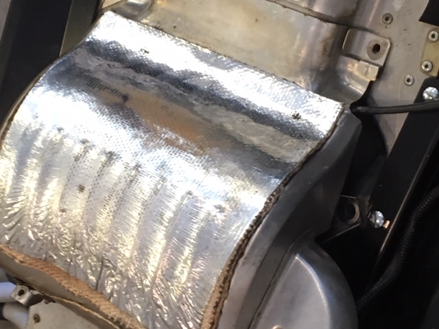

Can install any o2 sensor can you not then add a air/fuel gauge right? If so where in the pipe a sensor be installed ?If your putting on a PC3 or PC5 in, you must install a 02 Sensor, otherwise you are tuning blind and there is no point to it. Could be running super rich or lean, 12.6 to 13.0 is the sweet spot. anything leaner then 13.0 on long speed runs could melt down.
O2 sensor works well in this location on Apex

Thank you for the help. Starting to install everything today. Just gotta get a AFR gauge that wont break the bank and I'll have everything
