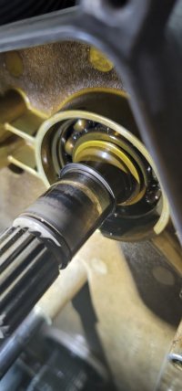

I was not as lucky as you. I need to do my to top bushing, very shot, full of sludge (was stock, ordered dmc), track shaft spun in bearing (stock, no saver installed), chain case oil was a bit milky and definately shiny (magnets were fuzzy) , not sure why oil was milky, I put green oil in there, it definately was mixing with something.

You got some moisture in your chaincase. That’s usually why it turns milky.I was not as lucky as you. I need to do my to top bushing, very shot, full of sludge (was stock, ordered dmc), track shaft spun in bearing (stock, no saver installed), chain case oil was a bit milky and definately shiny (magnets were fuzzy) , not sure why oil was milky, I put green oil in there, it definately was mixing with something.

Condensation
