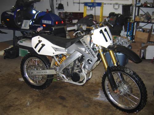

Cannodale, do you still have them American works of art? I rode a friends of mine when they tried the MX seen. Wanst a bad attempt except the transmissions werent reliable. Ripped-it at Red Bud, and while doing the old double up before the Monza wall (before they changed the track this year) the damn transmision let go and I cracked my hip and ruined his ride. Had to buy parts for it and I never owned one! It was expensive! I was just curious, dont see them anymore. Thanks for the input.

Nice bike.Yup addicted a quad and a bike and lots of parts.Getting over 60 hp now.Reliably!But I know what you mean.We the public did alot of testing for the factory back when they were still in business.Just think they were fuel injected way back in 2000.
