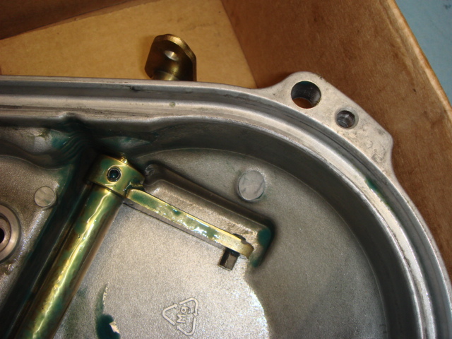

here is a pic of where the LEDGE is smaller on 06 cover....near the bottom of cover,where the large gear rides,the ledge narrows down,and the gasket would not seat real well here....you can see in the one pic below how the black marks from gasket are not seated very well around bottom of ledge....
the 08 cover(update cover) has a larger ledge where im pointing here....i do not have a pic of the update cover,but it has a slightly larger ledge near bottom and helps gasket seat better there....no seapage.
I am 99.9% sure the gasket is UNCHANGED .
Dan
Dan
