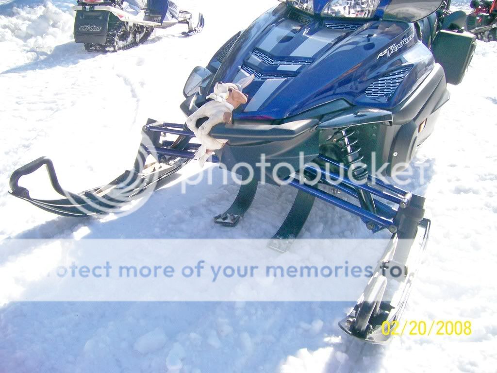

Probably not what you are looking for, but I found these to be pretty innovative.

not bad, not sure how they would work with not much pressure on the ground.
Those cable scratchers dont put enough down pressure to create enough snow and they fall apart too.
