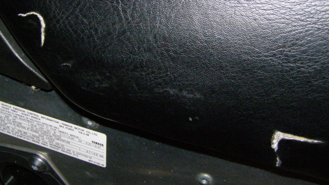

just replace the cover and get Boa style bbots then it won't happen

I've got the boot part figured out, thanks.

some auto parts places may have a vinyl repair kit

For tears like that, STITCH it with a needle and thread, then paint it with vinyl paint.

I used sikoflex black slicone worked great.

niko, which sikaflex did you use, 292? No problems with cold weather?

No probs with cold, it was 292. If that stuff gets on your hands my god!! takes ages to come off!
I applied it with the nossel then used a little water on my finger to smooth it out.
