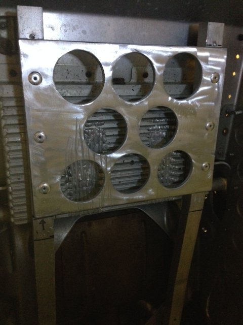

The studs thing will need to be fixed with adding more protection to the cooler not with a spring setting.
I added an extra inch to my protectors in the heat exchanger area.
You can see previous damage before adding the extra layer.
Thanks for all the replies everyone! much appreciated, i tried to post a pic from my phone of what i did to add protection but it wouldn't work so ill try from my laptop.
