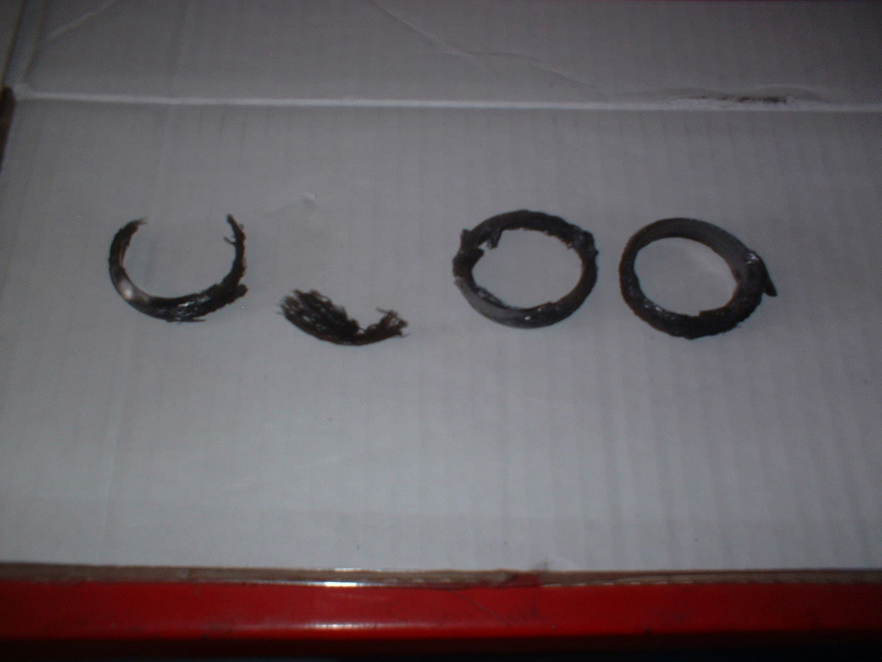

I have a rx. I just finished replacing my exhaust doughnuts.They were all shot.Same exact symptoms you described.I have just over 5000 miles on mine.
RS should be the same ,remove seat, tank,heat shield on top of header pipe,clamps that hold exhaust together(5mm allen) then remove four bolts that hold muffler in place(under another shield) then remove two allen bolts in top of tunnel that are under rubber covers(5mm allen also).Complete exhaust will now slide back some and you can get whats left of the doughnuts out.
When putting new doughnuts in you must pry short accordion looking exhaust headers foreward a little to get doughnuts in place or you could get a new exhaust gasket that goes on head and remove each flex pipe section individully and replace doughnuts that way.Doughnuts are a little over 10.00 each,any qestions PM me.Heres a picture of old doughnuts.

Oh yea nice and quiet now and seemed to pick up rpm,s,will find out tomorrow for shure(going riding).
