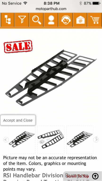

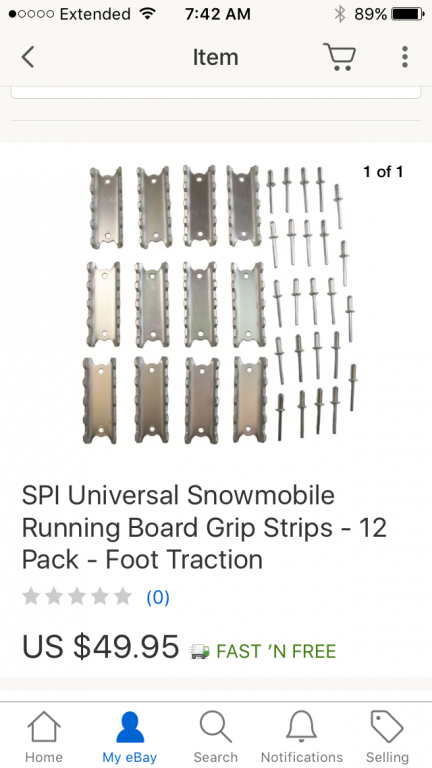

You can. There are aftermarket grip strips that you can install on the outside edge of the boards as well as insert for the boards themselves.View attachment 125447 Why can't a guy put these on? There are lots of rivet tabs on the heat exchangers and about half are not even used so what if a guy has to tig a couple small pieces on the boards for a exchanger mount?

Don't drill into your coolers or the job will get a lot more interesting LOL
One issue with agressive boards over the stock ones is that the snow doesn't fall out. You end up with even thicker slabs of ice that can cover your added traction.
Ding
The real answer is to move the coolers, but yes this gets expensive.
