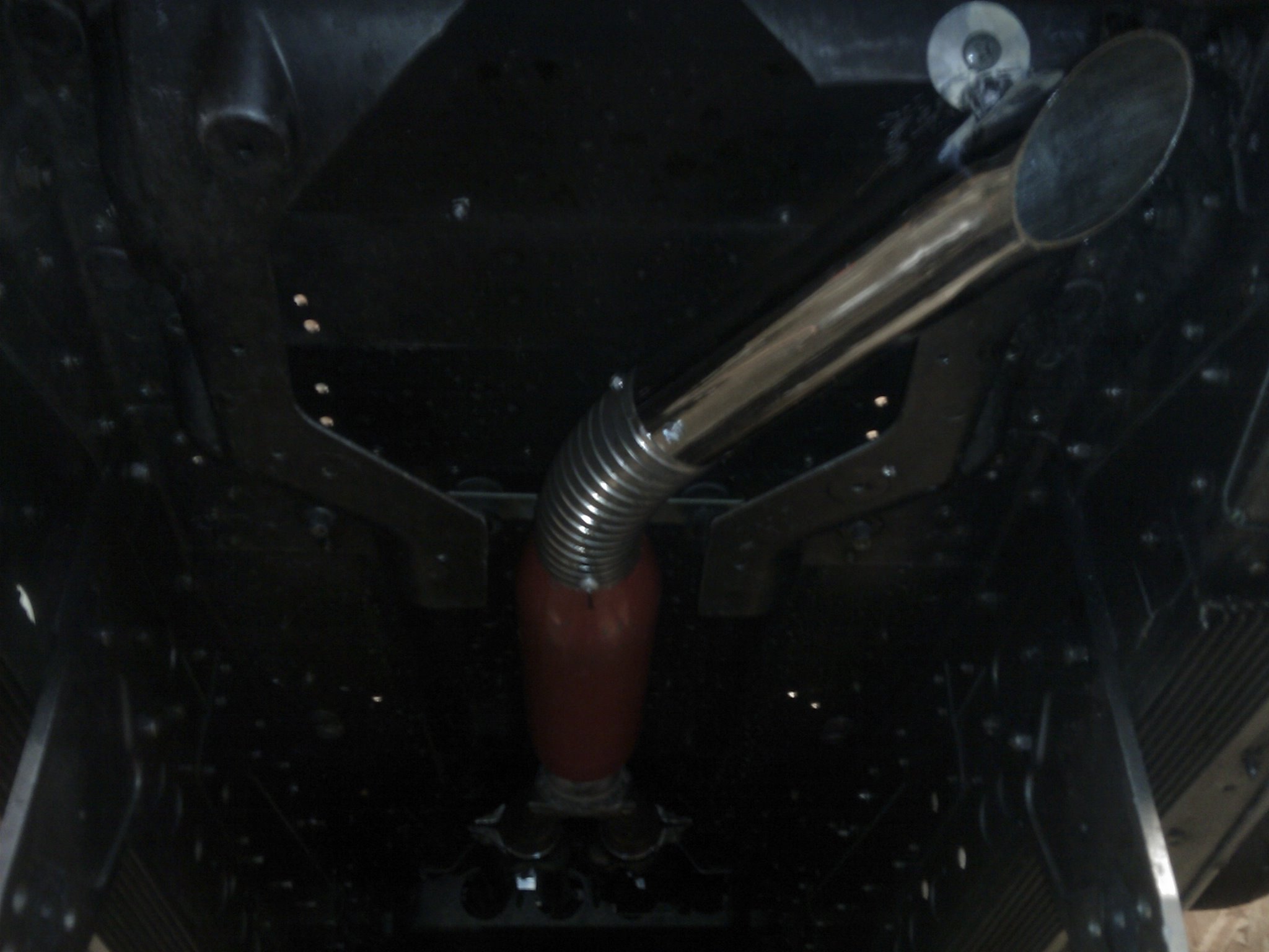

We have various methods of under tunnel on 10 tons. I recently tried Rockmeister's version ( Napa glasspack with a harley baffle) on my sled:
http://www.ty4stroke.com/viewtopic.php? ... el+exhaust
with a turn to the side to minimize snow and ice build-up on the rear tunnel and suspension. It turns out being slightly quieter than just the glasspack at high throttle levels, and I've ridden without earplugs for the first time in years. We hit some steep/deep stuff and I saw no difference in power compared to the non baffled tons. It was above freezing (as it ususally is here) so I don't know if it will avoid the ice build-up. Important to keep it tucked way up to avoid the track.
Sorry about the crappy phone photo.
