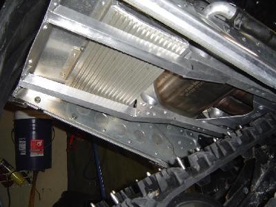

i just instaled the rear exchanger and the extra long tunnel protecters he said id have no problem instaling them but how do u get the the 2 rivits at the from of the tunnel the lower heat sheilds in the way dealer said they have never done them so all he told me was with the seat and tank out its a breeze i called him and said how u get at the 2 front rivets were they bend down by the front cooler he said i didnt need them lol any body got a trick or do i have to take all the exhaust off ? :o|
has anybody put protecters on a warrior those to rivets at the front guess i have to pull manifolds and bend that heat sheild up to get at them
there done man what a afternoon had to remove some exhaust and that but there in now to put it all back together lol

ya the yamaha kit went in easy i took pics to show my sleds etting all back together all a arms painted and plastic painted gotta get pics up
didnt take the easy way out adding to rear i did the full kit
