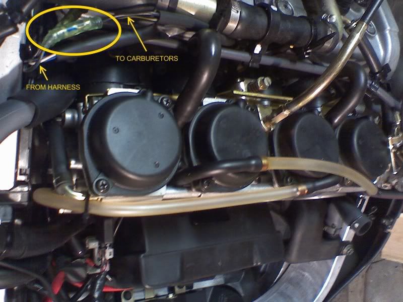

It would help to know what sled this problem is on, but if it's an RX-1 I know the TORS wires run right between the carbs and engine and have pin-style connectors with a greenish plastic covering. Unplug the TWO connectors and then plug the two coming from the harness (not the two going to the carbs) into each other to bypass the TORS.

RedRocket
scottytohotty
- Jan 3, 2009
- 12
- 683
Cool thanks for the picture this site is awesome or maybe its just that yamaha owners are always willing to help out. Anyway after sleeping in the heated garage all is well but if it happens again at least I know where to look. thanks again.
