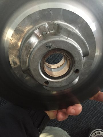

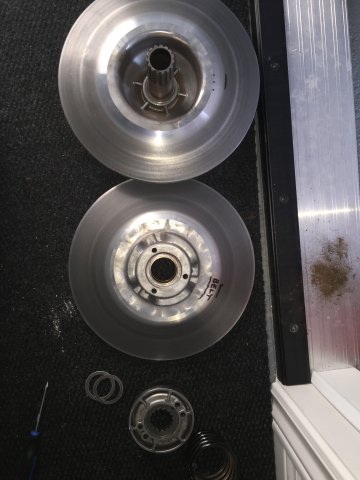

Hi, could use some help here.
Followed the steps in tech folder to clean secondary. Also cleaned primary the other night.
Haven't touched since new last dec and currently have 5500 on the dial.
After cleaning and reassembling "dry" and no lube I was on a long ride yesterday and started to notice my rpms creeping up and speed dropping. I did pull over several times and check temp of prim/sec and I was able to keep my hand on them. On the last 50 it started getting really bad and they were so hot the sweat on my hand sizzled on them. Belt was red hot too.
Pulling apart this morning it seemed, to me, the helix was sticking for some reason. Could barely push it in to get clip off.
Things I noticed:
1)Copper dust like crazy in there.
2)Helix was not moving freely on shaft. Was very hard to get down not smooth at all.
3)Helix did slide smoothly in/on buttons (not assembled, half sheeve only)
4)inner most copper ring (there's two with the grooves) was worn right out. No groove in it at all.
What the heck did I do wrong??
Put 271 on the dial yesterday with some long straight runs I kept rpm in the 11-11500 range.
Will post a few pics shortly.

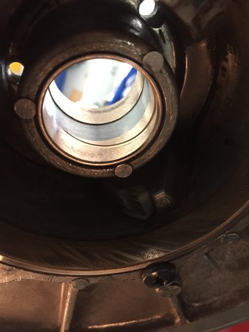

They were perfect before cleaning.
The bushing on the main shaft was ok.
It's the outside bushing in the sliding part of secondary that's pooched. Pic above shows the pile of dust/coarse bushing. There's to much play when reinstalled to run it. I'll probably do more damage.
I'm still thinking I should have greased where it called for it
