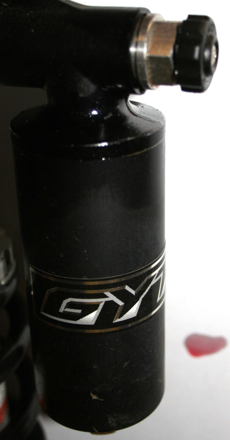

If you have a lot of miles on them it wouldn't be a sign to get them rebuilt and have the problem fixed...I wouldn't run them that way, its ok for run or 2 but not a full season, I just got a set for mine I hope that this isn't a common thing for these...if you get them rebuilt get them shimmed to lower your C.O.G. I've put 200 miles on mine so far this year with this set up and what a difference in handling, she rails in corners here are a few pics...
