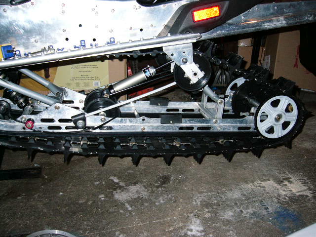

Well, I ordered the 153 rails in for the M7 skid today at the dealer! Should be here in a week or so. I will order the hyperfaxes for it when I get home today and the tunnel extension from Hartman Monday. Frostbite.....you think I should get the 159" or 162" extension??? I'm thinking the 159 might be enough. So.........now it's time to get a track coming! My dillema here is clearance. Obviously I want a 16"x162x2.5 but not sure I can have my cake and eat it too though! Looking at my sled I don't see any way the 16" is going to squeeze between the rear mounts. The 15" is really close already. I did read also Lee that the 2.5" lugs are hitting up front around the drivers and so what should I get?? I want an aggresive bite. We all know we have the horsepower to turn it and I'm not worried to much about heat issues going bigger lug. Looks like I might be 15" wide with 3"pitch huh? I guess just not sure what type. Any advice? Thanks!

Ewwww, just looked more closely at your pics, and did a little measuring on my skid. It looks like its the SKID drop brackets that may be the limiting width factor eh? Alarger top wheel would solve that but create the other obvious issue. Now what, a custom longer axle?

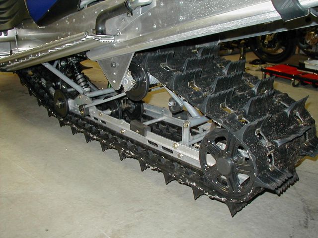

I guess I should have explained a little better. The bottom picture above shows Frostbite the clearance between the track and the skid mount from a phone conversation we had earlier. If you look at the picture close you can see that a 1/2" wider track would rub on the mount. Not sure if I can run a 16" w/o issues. As far as the sliders go Pete, They don't show any wear but I am putting the hiperfaxes ($160) on the new 153" rails since I am going to a deeper lug. Mark, the tunnel extensions alone are $210.

I see what you mean about the track not clearing the little arm looking gizzys near the drop down brackets. Something doesn't look right. I need to go out into my trailer and look at mine.

Lee, there is a picture of the rear seat over on the "Thunder Jet" thread. Would really like to talk to someone running a 16" on a M7 skid! If my wheels were 1/2" bigger it would work. I think the 156" would work fine, because it would equate to only a couple inches back there. Not sure on a new track that will strech some? Let me know on the pipe. Good visiting with you also!

Looking back, here are some pics of a 16" Maverick on a 1M 151 skid. This skid is virtually identical to an M7, particularly in the rear. Looks like the skid bracket leans forward enough that the track rides over top of it. Could possibly rotate the bracket forward one more notch on the hexagonal shaft, then go with a lower tunnel bracket hole???
Could be the skid bracket on the 1M is shorter than on an M7.
Well someday, I will find out through trial, and error...

Good find Mark! I just went out and looked at mine and they are about the same 45 degrees or so. If you went one more flat forward on the shaft it would be horizontal.
