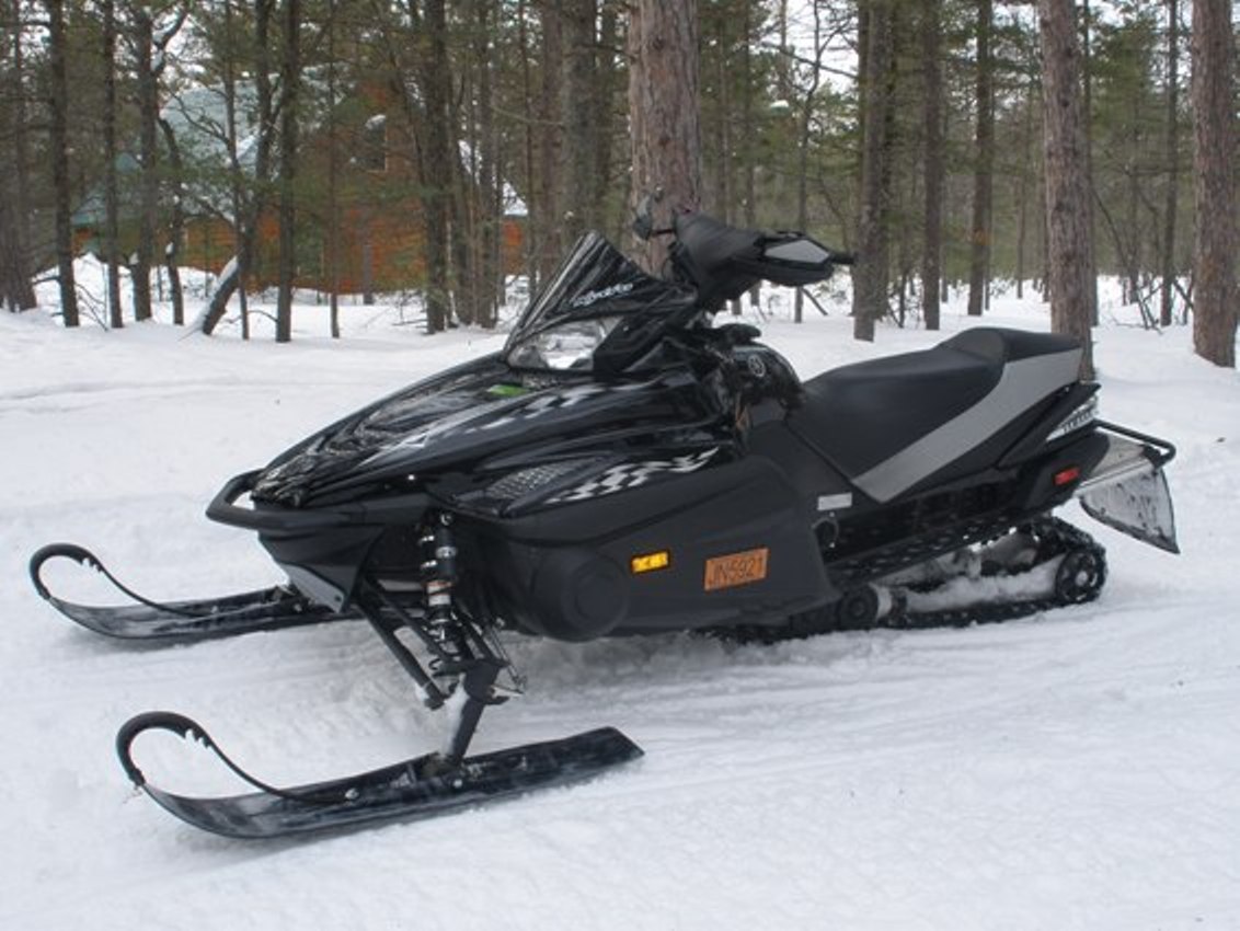

I just bought a 07 RS Rage GT in black the other day. I was hoping to see some of your pics of what color of skid plate you have on your black sled. If you have any please post or send to me.
How straightforward are they to install? e.g. are they screws going into predrilled holes on the bottom? or what?
I was thinking about the silver one to put some accent to the black sled. Or mabye just keep it simple on the eyes and go with black.
Thoughts?

Personally I'd go with black.
You will have to drill 4 holes, be careful not to drill to deep and hit your motor!

I also went with the silver/grey skid plate. For the install you have to drill 4 holes (11.0 mm if I remember right) in the bottom of the bulkhead for rivet nut inserts. Be sure to use a drill stop when drilling the holes. I use a socket slipped over the drill bit for a drill stop. G.B.
