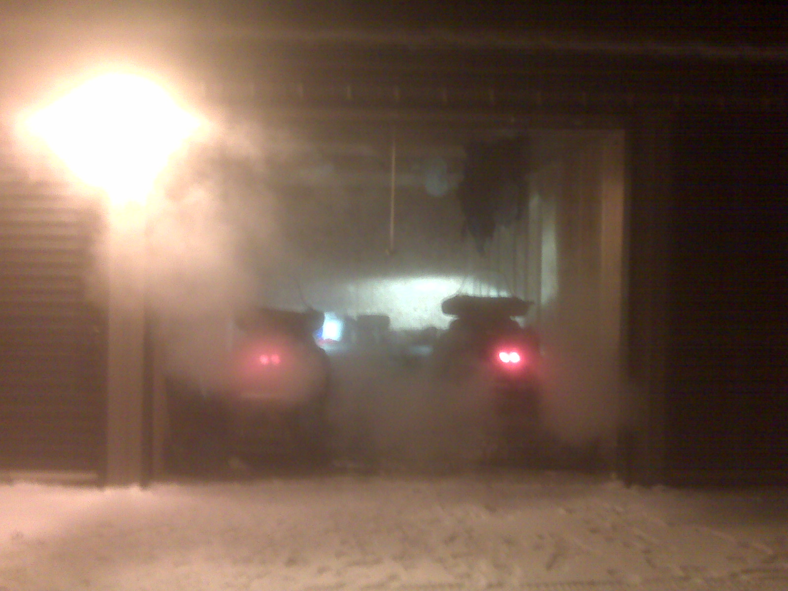

I cleaned my carbs in fall. Started it 3 weeks later and it didn't seem right. again! I used (what I believed was) a full tank of 100% gas and stabil during the prior season and always run for about 10 minutes so it should be warm enough. So I drained my bowls and called it quits.
Just fired the "twins" up and they ran almost perfectly (one's on a lift)!! I have no idea what gives? Just to be safe I then ran 12 oz of Seafoam and will probably continue to do so.
"Oh happy day!!!"
