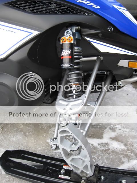

As soon as I get a chance, I will show some pics of what I did.
It is hard to see once the saddle is mounted into the ski with the rubber and spindle. Sort of covers thing up, but you'll get the idea.
Originally I installed with the mounts that came with the ski and wasn't happy with how much the ski bounced back and forth. Then I took the steel saddles and made some aluminum frames that gave support front and back to the rubber. This worked somewhat better. Ultimately I decided to build some new one. It also helps that I have the resources at hand to do this.
I did initially find that the keel sat lower that the OEM ski's by about 3/4". It was hard to get exact measurements but that's what I came up with.
Believe me, that extra bite made it very hard to steer (I'm not the most muscular guy), hence the reason it took me a season to get where I wanted. Someone more experienced with setup would probably be able to find thier sweet spot quicker.
