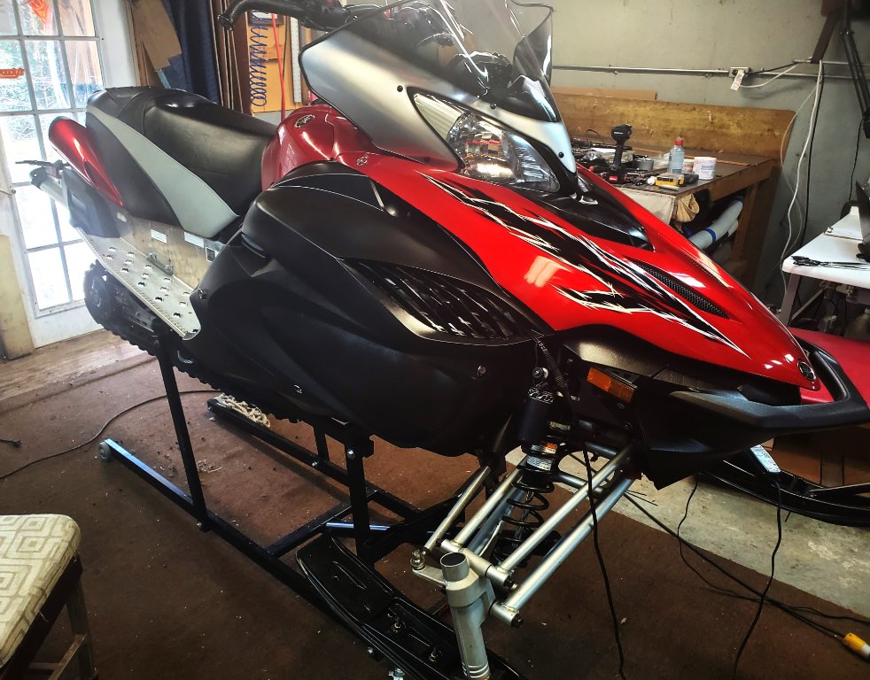

I've been looking for a spare sled for a while. I found a 2010 RS Vector LTX GT. Has 321 miles on it. So I went down about 2 hrs to look at it with cash and trailer. We'll was bummed to see the windshield was dull and faded as the plastics. Seat was ripped bad. Mice got pieces of foam from inner part of the black shrouds. Well it started right up and held a great cold idle. So I bought it. Luckily no chewed mice damage. Just some corrosion which I cleaned up and painted from were they peed at the bottom of the fuel pump lid on tank.

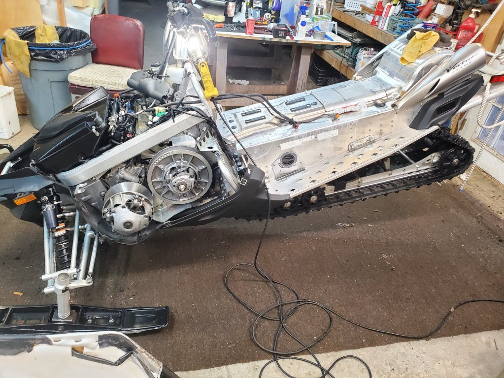

I brought it into my shop and started in on it checking it out. Pulled it all apart after a while. Couldn't help it. Loaded with squrriel next's mice nests debris. Oil was odd looking ..chain case oil white looking. Don't know how water could get in there yet if it did. In hindsight I shouuld of caught the oils in a jar and let it settle to see if water was in there.
I flushed out all the squrriel/mice stuff from around and under the engine. Installed all new bearing in all wheels and packed the clutch side bearings as they were getting dry. Also ski's were out of alignment which I set back to spec's.
I used Back to Black plastic renew stuff and it is amazing thatnks to Project Farm's tests. New battery,windshield, seat cover and still working on it. Going to stud it this week with studs and pattern from Woody's. Which I used for near 40k miles combined riding machines and no issues. Very very few got bent and none pulled thru.
The machine was White from Yami and I got some Candy Apple panels used. My wife has a White Vector so this was a must. So beware of old low low mileage machines. 2010 is 15 yrs old and with 321 miles it sat and wasn't taken care of really. But I could tell 321 was real with it. Skid was like new as al the other parts that should of rusted with age and or mileage. A arms, Trackm, steering parts, etc.

Finally got some snow. At least enought to ride this machine for the first time on my town dirt road around last night for about 7 miles. I wish my 2016 ran this good. Looking forward to trails opening so I can ride it for a couple of hundred miles to be relieved nothing is wrong. My concern is the old antifreeze was good for only 10 below 0 f. And over the years here it gets -35 some times in the morning early. Damage done from that ? who knows. I need to run this machine alot then check antifreeze level,oil's for water in it etc. Beware of old machines sitting.

It's really a spare at this point but I'll ride it mainly this season first thing. My 2016 is loosing favor with me due to bad idle,hard to remove upper wheels for service. Plus single shot suspension. Price I paid? we'll sort of too much for some not for others. I'm okay with it being what it is. 330 miles. Paid 5k for it. But put money into it. Here in New England it's hard to find one with low mileage and under 6k. Again my wife bought a 2010 Vector ltx brand new in 2010 and put near 10k miles on it with only dounts to do. So if if the cooling and engine system work as it should I'm happy.

Why not just replace the coolant? It's EZ compared to what you did to the sled.Finally got some snow. At least enought to ride this machine for the first time on my town dirt road around last night for about 7 miles. I wish my 2016 ran this good. Looking forward to trails opening so I can ride it for a couple of hundred miles to be relieved nothing is wrong. My concern is the old antifreeze was good for only 10 below 0 f. And over the years here it gets -35 some times in the morning early. Damage done from that ? who knows. I need to run this machine alot then check antifreeze level,oil's for water in it etc. Beware of old machines sitting.

I did replace it during the restore. The sled had oem when I got it with old Blue antifreeze which only was good for 10 below F so I changed it then.Why not just replace the coolant? It's EZ compared to what you did to the sled.
