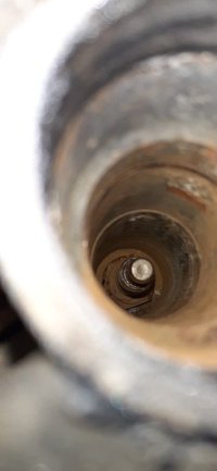

My apex 09 1000cc had only 2 years spark plugs and 1500km on those ..he run good this summer ehen i start ot a gew time and 1 week ago tje weather was humid and he wont start...I'm guessing you just got some water or snow in the plug cavity on top of the plug. If its running good now, with the new plugs you should be good too go. Keep an eye on that cylinder though.
I checked the plugs ..
1 was very rustyy..see picture.
Sp o replace 4 plugs and the fourth ignition coil was rusty too ...
Tomorrow i install new coil..will see if run good

I know early on with the RX-1's, the coil packs would go bad and could tell in low light when they arc between them. Haven't had any issues with the coil packs in my 08 Apex. Yours may have just needed a good cleaning due to spark plug corrosion so might want to keep as a spare.
