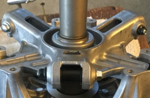

The clutch will fit the taper, the offset will be the same, but the problem is that on the SRX clutch (2 stroke) they don't have the windows in the spyder of the clutch to clear the large weights the RX1 has.
Below is a 2 stroke clutch spyder on the left and the 4 stroke clutch spyder on the right.

That being said my HC's from the SRX will not work in the RX1 clutch, they are not heavy enough? I read somewhere (I thought in some instructions) that they would.

I don't think the HC's will be heavy enough.
