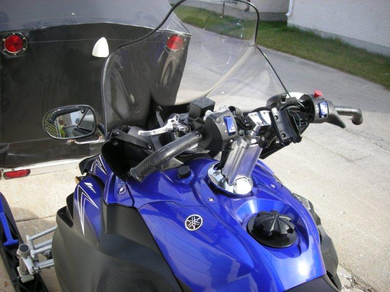

Got the oft relocate installed and when im seated i cannot see the boost and afr guage. Is there a angle or a off-set riser out there with a bit less angle than the oft relocator

Are you running the stock riser? If so you could go to a pivot adapter or a RTX post and be able to put your bars wherever you want them. Then the relocator is helping with the swing of your bars and far better bushings. Even if you have to relocate your gauges, the benefits of the relocator will far out weigh moving them. Assuming you just put it on? Once you ride it you will love it. ;)!

Stock riser and oft. Where can i get a pivot adapter?
The stock riser on the mtx is long and with the oft bracket its a bit extreme for me , sure the bushings is better but you can buy them one by one.

PM superman or go to Lakeaffect riser.
I replaced the stock riser with his riser with a pivot and with the oft relocator.... He has all kinds of different length ones. I went 1.5 inches longer and it fits me perfect now....

bjerrang, sorry I didn't get to this sooner. All we can offer is a pivot adapter with a riser on top like Stoli has linked above. This "might" do what your looking for but there is no way to say for sure without mocking it up.

Can i use the stock mtx riser and go for the pivot adapter only?
You could use the 2.5" pivot riser ($65.00) on top of your factory riser but the 2.5" pivot adapter ($50.00) will not connect to the bottom of your factory riser. I will try to post a picture soon.

Good solution also.
Got help from superman.
Since the oft lifts the total height about 2 inches.
I just cut the stock riser 1.5" and fix the bolts.
