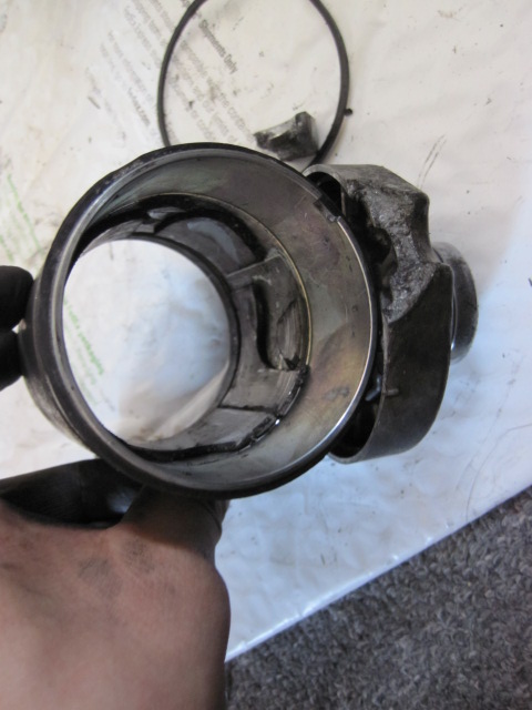

been turning key and selenoid just clicking thought it was bad selenoid changed it still the same clikity click click until i open up the starter motor to check brushes and found exploded magnets has any one ran intot his problem ?

i think rockmeister sells a kit to let you know when this is happening. it seems that the starter sticks and stays running the whole time the sled is runnin and you will never hear it

9,000 miles and you can see the the bolt hole busted also clinging outside the magnet cover too man just when i was going for a good ride had to happen.
