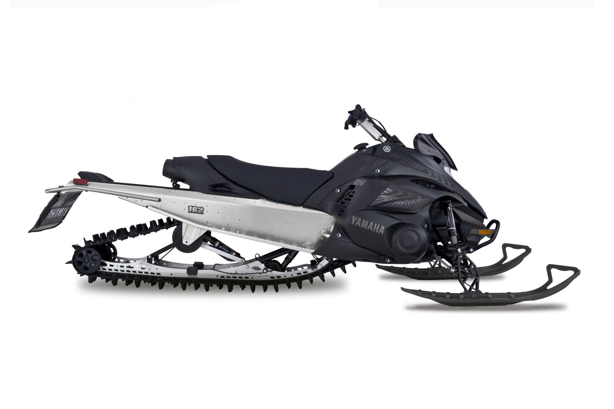

OK, looks like the guys that assembled my sled were having a bad day.............. my scratchers were mounted off the top arrowhead block. I can see the other pictures (like the one in this post) have them mounted on the same spot as the front shock idler wheel shaft.
Anyone able to give me a parts breakdown of the scratchers and how they mount to the rails and into the front idler wheels that run inbound of the slide rails? Would be helpful, as I have a bunch of non normal looking hardware in there.
Could use:
Parts and the order they mount in.
Could use:

They are mounted differently because the newer nytro has interior boggie wheels and a cross shaft that bolts to the rails at the same location where the older sleds have boggies on the outside of the rails. On my '08 they just removed the boggie wheels and instaled the scratchers in their place. it looks like they just mounted them higher because the did not want to mess with the cross shaft and wheels. they look like they would work in either location

Well, both pictures above are from the newer sleds 2010 and up. Might even be the same year?
Anyone have the order of the spacers and washers and STUFF? I can't find a parts break down of this anywhere!

I have the Yamaha aftermarket scratchers (which are Scorchers scratchers in a fancy Yamaha bag...) and I have got them mounted according to the second picture - on the front bolt of the triangular center swingarm bracket. Mounting according to the first picture is impossible because the flat surface needed under the collar / scratcher spring is not big enough.

Ours were both mounted in the rear hole on the triangle piece. Just remove the bolt in the bracket and use a longer bolt in your scratchers. Ours broke in 3 rides on the trails and I went with Dura flex cable scratchers instead.
