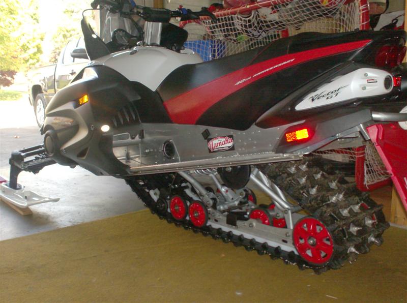

I am looking to replace my square backers out for some round backers as the square ones have spun/turned and are in a position where they could cut my track.
I purchased some round backers yesterday at the T.O. sled show but when I came home and tried to remove the old ones, I quickly found out this wasn't going to be an easy job
I am running Woody's 1.325's SS studs (I believe?) and when trying to remove the nyloc nuts, they get caught up on the damaged threads that are exposed above the nut.
The only thing I can think of is to try and run a thread chaser down the exposed threads in order to clean them up and make the removal of the nuts that much easier ?
I am trying to save them and re-use them if at all possible but I know this isn't going to be easy!
Any tips/suggestions on what others have done?
