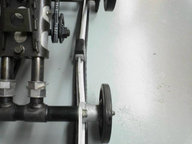

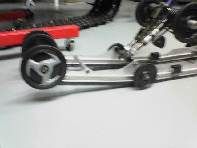

I would love to see some pics of these bends.
This sounds whacked.
SRXSRULE
My pics look identical

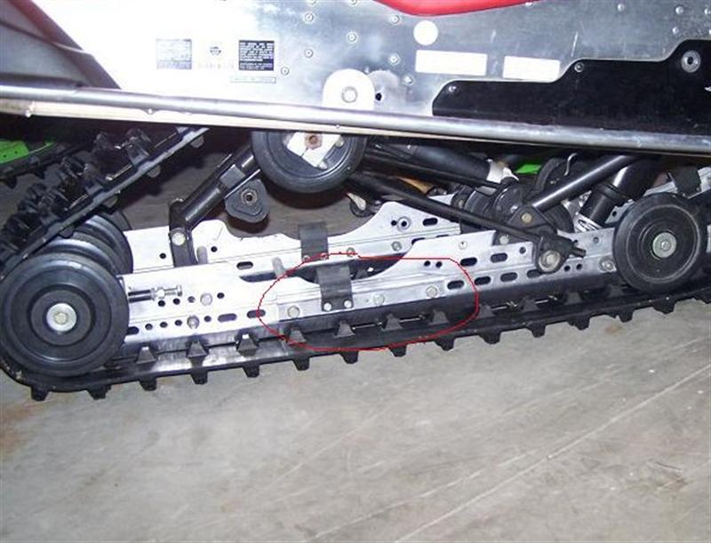

After looking at the skid, there is approx2' between cross shafts, and Pro 116 said adding another cross shaft may do the trick. I will be doing mine this week, a shaft at the 136" point, and maybe another one in front of that
