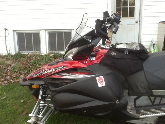

The 2" suggestion is the simplest and quickest. I've run my 06 Attak and my 11 Apex at 5" over for a combined 12,000 or so miles. Re routing brake hose, parking brake cable and throttle cable makes this possible. Not for everyone, but it gives you the knowledge that you've got a little more rise available should you need it.

i run a +3 lake effect and all i had to re-route was the throttle cable like viper_dave
