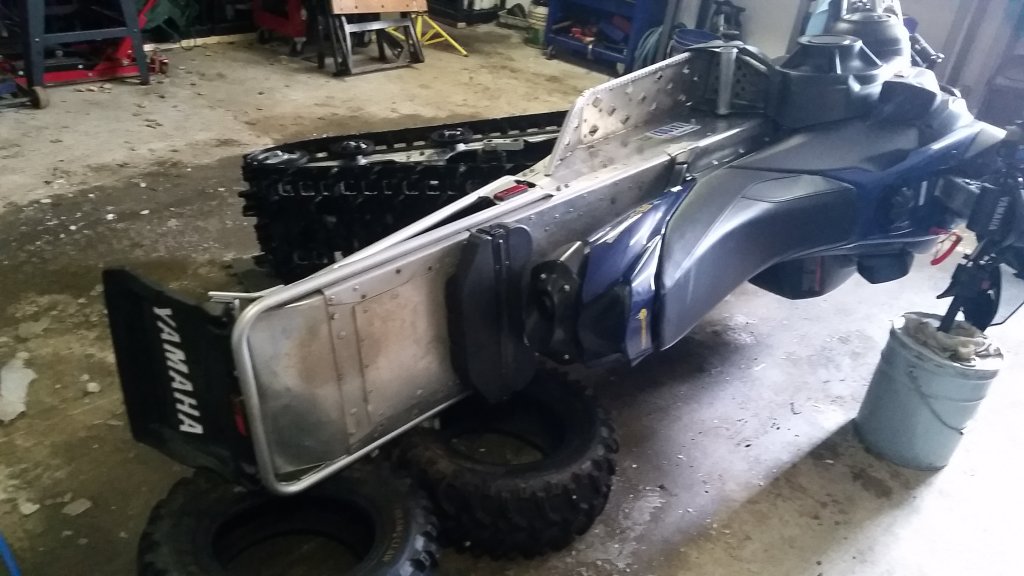

So everyone has their way to pull the skid but I think this is the easiest way to do it. You don't have to remove any rear wheels. You don't have to ratchet down the skid to get it in or out and you don't even have to loosen of the track.
First thing is to flip the sled on it's right side. I placed a couple of ATV tires under the back of the tunnel to lift it up (important). Loosen off the two front bolts that hold the skid in but don't remove them. Once its flipped over remove the rear bolts that hold the skid in.

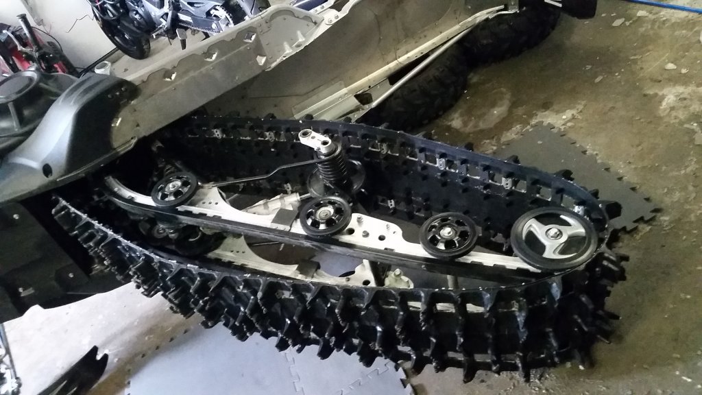

With the rear bolts removed allow the skid to pivot out.
Move the skid forward and the track become very loose allowing for an easy skid removal.
Now remove the two front bolts to remove the skid.
Took about 20 min. When reinstalling you don't need to collapse the suspension. There is enough slack in the track. I also did it this way when I had the 121 skid and works just as well.

Easiest way I have seen so far, Cannondale or Yamahas you should add this to the stickies/faq section

I've never thought of this way. Had mine out 5 times the hard way

Great post Ruggy, Thanks!

So rotating the sled to that side is a non issue since the oil resevoir is on that side? I need to do a track swap before next season.
Roll it to the right. The oil will stay in the reservoir can. When you flip it back on it's feet give a couple of minutes before you start it to allow the oil to settle back too where it belongs.
