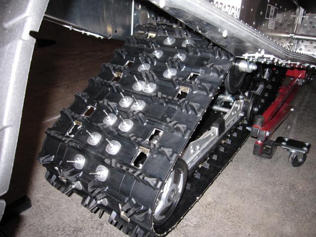

I have had studs on almost every single sled ive owned. Im not a pro nor do i claim to be but one thing is for certain......... if you don't put enough studs in you will for certain be tearing out studs and or bending them. I have only 300 miles on my studs and am already seeing some bending (these have a 2 yr. warranty against bendage and breakage so i will send in the bent ones and get new ones when the snow melts.). I have the extreme max 1.4" carbides. 144 placed on the inside and outside of the track. I'm wondering if i may not have enough studs? The amount of torque these machines produce has to really be putting a huge amount of stress on the track and studs.
By the way, im very impressed with how 144 of them hok up.

Why not swap the track out for a an Ice Ripper XT? It's pre studded and there's no worry about the studs tearing a big hole in your track and taking out your heat exchanger, plus no maintenance for them either.
I can't see myself going back to traditional studding.

I would think adding tall nuts would help cure the bending and alleviate the pull outs. Would it not? I am thinking of doing 96 1.325 woody's megabites with tall nuts.
yami ryder
192, woddy 1375 megabites with medium nuts. 4 studs per track lug inside and out I use a modified woody,s template with blue locktite on all my sleds and buddys sleds never had any problems...If you pull a couple sleds out in front out of the hole a little top end loss will not matter, they have a hard time catching up when you are already out in front.
