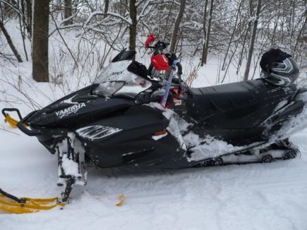

I made my 06 APEX RTX a 144" over summer. I used the cobra track but took it out and put a deep snow track. I relocated the skid in my sled to get it up on top of the deeper snow. But the funny thing is that it help the handling out alot more hook up and it help it turn don't know y it help that out but it did. I rode a 07 APEX RTX 144" that the guy did not relocate the skid he made the skid a 144" not a 136" relocated. It rode like a tank it put alot more sled over the ski. Hard to trun and it likes to dig in the snow not get up on top of it. Here is the post I did about a 144"
