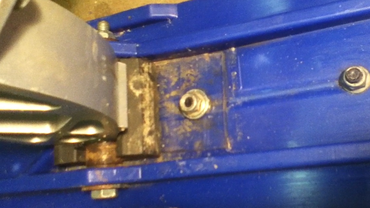

I shimmed mine (XTX with the Yamaha mountain ski) and noticed a nice reduction in darting on the trail.
I tried reversing the rubbers, but it seemed like it was putting a lot of stress on the rubber, so I made a couple of shims out of an old piece of track instead.
To check yours to see if it's been done already, just pull one ski off. If it's been shimmed there will be a shim of some type under the rubber on the back side, between the ski and rubber.
Bill
Shim them 3/8". Check out Bergstroms website it's good reading.
Also in the FAQ section there are some great setup tips.

Flip the rubbers. The high side of the rubber, should be in the back, when they are flipped. Stock high side in front. When I'm not riding I put a 2X4 under the skis, about 6 inches in front of the pivot point. This takes the pressure off the rubber so it doesn't deform and take a set in the squished position. Works great, zero darting.
