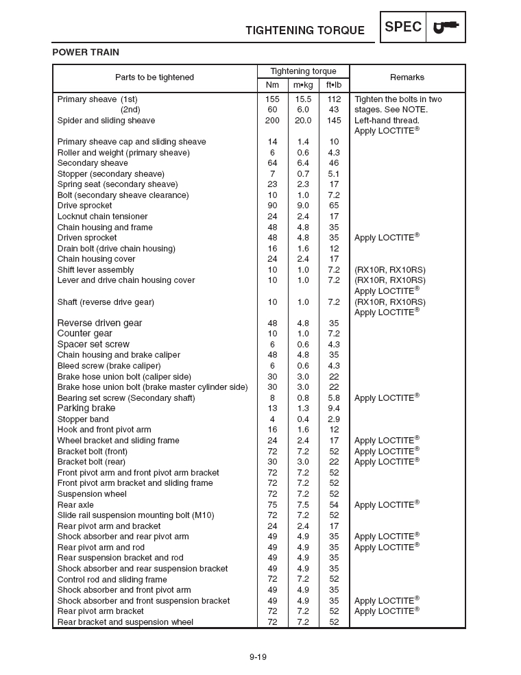

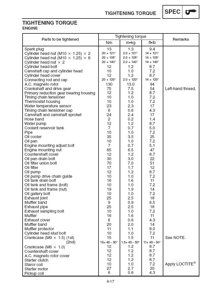

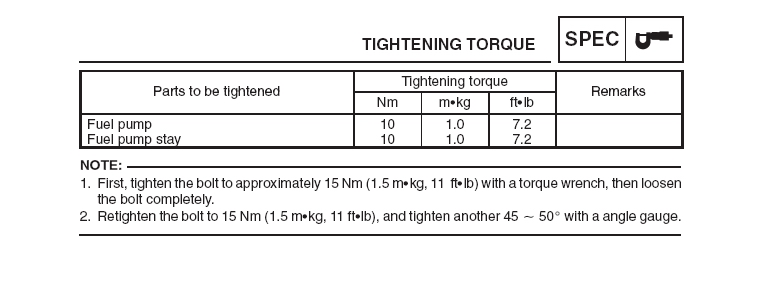

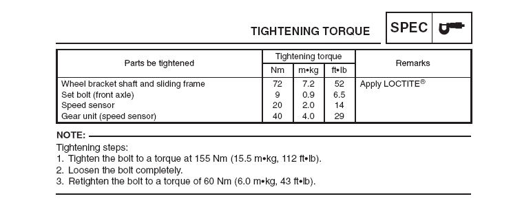

Anyone know what the torque specs are for the clutchs?
Need to know the spec for the primary clutch nut and weights and the secondary main nut and the helix
josh
Specs for 03 Rx
Here ya go....But be advised that I was just informed that the Yamaha manual may have had some incorrect torque amounts...specifically for the drive clutch....So please get a second opinion before using these charts...I am told that 85 is the proper torque.
