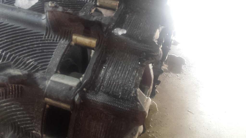

I went in a 1700 mile trip to the Gaspe and at the end of the trip I felt some grinding and shaking under the sled. I thought maybe I was just grinding ice under the tunnel and it eventually went away. Got it home and looks like the right side of the track is all tore, the lugs are all gone and the tunnel protector is destroyed. Any ideas what can do this. The track only has 6k miles on it.

Looks to me like it d-laminated or got cut in one spot and then just got torn off and destroying the tunnel protectors in the process. 6,000 mi the tracks will start to deteriorate.
I got 17k miles out of my original track and was in ecent shape truthfully when i changed it. What was the stock track for my 2011 Apex?
Looks like something got jammed in there or the tunnel protector came loose and wore the track. That is not normal wear.
