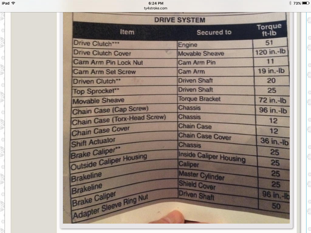

Can anyone tell me the torque specs for inside the chaincase(driveshaft/jackshaft) and the case itself?
Thanks

I don't know the specs but I know you will want to use some blue locktite on the driveshaft bolt. Ask me how I know lol

Cool thanksHope this helps

I'm trying to remember what drive shaft bolts you are talking about. I remember the three bolts that hold the brake caliper/bearing holder. The chain case and brake side of the drive shaft is held by circlips.I don't know the specs but I know you will want to use some blue locktite on the driveshaft bolt. Ask me how I know lol
Pstn head
NP... and yes blue lock tight everything.

I am sorry I have not had one of these apart I was speaking from my history on the apex and having the axle bolt back out and cut a hole in the side of my chain case cover.I'm trying to remember what drive shaft bolts you are talking about. I remember the three bolts that hold the brake caliper/bearing holder. The chain case and brake side of the drive shaft is held by circlips.

To be honest most of the older sleds did have bolts but now many use circlips. The one thing to remember is that you will need to remove the front cross shaft in the rear suspension to get the clips back on the drive shaft. Both ends of the drive shaft are held by the clips.I am sorry I have not had one of these apart I was speaking from my history on the apex and having the axle bolt back out and cut a hole in the side of my chain case cover.
