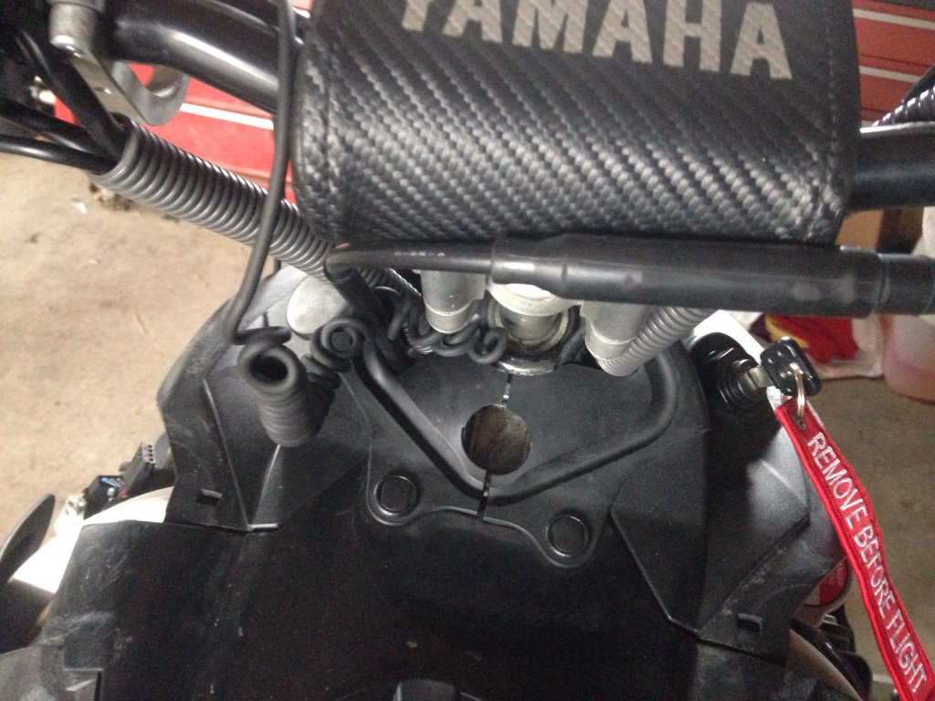

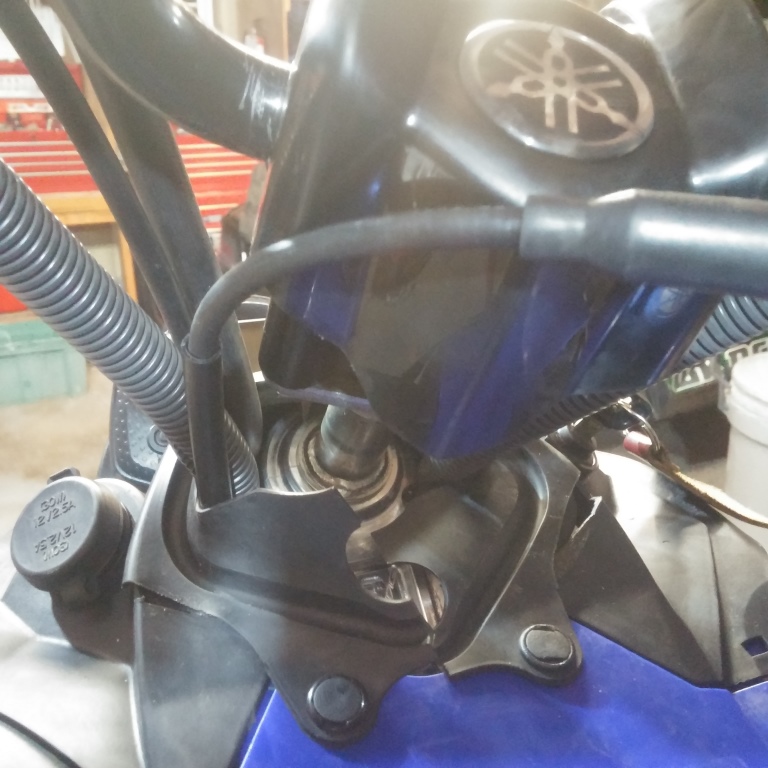

I installed the OFT relocate kit and I am very happy with the result. The throttle cable was rerouted as per the install instructions. I think the previous owner install a POWERMADD riser, which is making both the hydraulic brake and parking brake cables tight. I trimmed as a much as I could out of the dash, but the rubber is still binding on the cables as I move the steering.
It may be best to ditch the rubber gasket and just add some trim to the plastic lip. Is there any reason to keep this closed in? Is there something I could buy from Home Depot to trim this in so it looks nice and prevents the cables from chaffing on the lip of the plastic?
I would try an auto parts store for some rubber trim for older cars. Or what would work is a piece or the rubber trim that was used on vintage sleds that went around the fiberglass hood. It was cheap but I haven't bought any in years. The trim I am talking about was on a 78 Arctic cat jag around the hood that met with the dashboard and tank. You could buy it by the foot or less.
Here is a photo
of it binding. Not sure of others have had this issue.
I simply removed the rubber all together....no wire chaffing issues in 4 yrs of install time.
What he said. I have 10000 kms without the rubber piece. No issues or signs of issues.
Like the earlier comment, follow the instructions and trim that rubber piece and it will fit together nicely.
