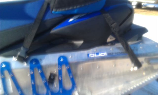

let me guess....no place to attach the rear straps. if thats your problem let me know and, i'll shoot you a couple pics of how i did mine on my nytro xtx (super easy)
Boston RX1
After riding 7 seasons with no problems with the bag mount plastic clasps, I had three failures in 85 miles. For some reason the plastic clips would not hold. I finally came up with an idea of a more secure way of holding my bag in place. Below is a pic of what I had, and what I did. You can see the plastic clasps are still on the tunnel. Sorry for the blurry pic, I dropped my camera just minutes before and I think I damaged the lens. The stainless steel strap ties I purchased from www.wholesalemarine.com, the part number is S-D-081261-1 and I riveted them with stainless steel rivets. Very happy with how this came out.
