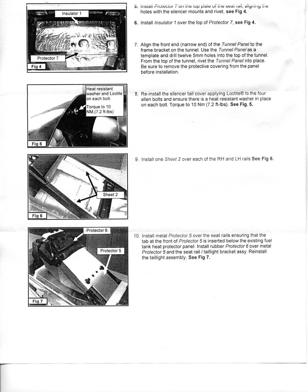

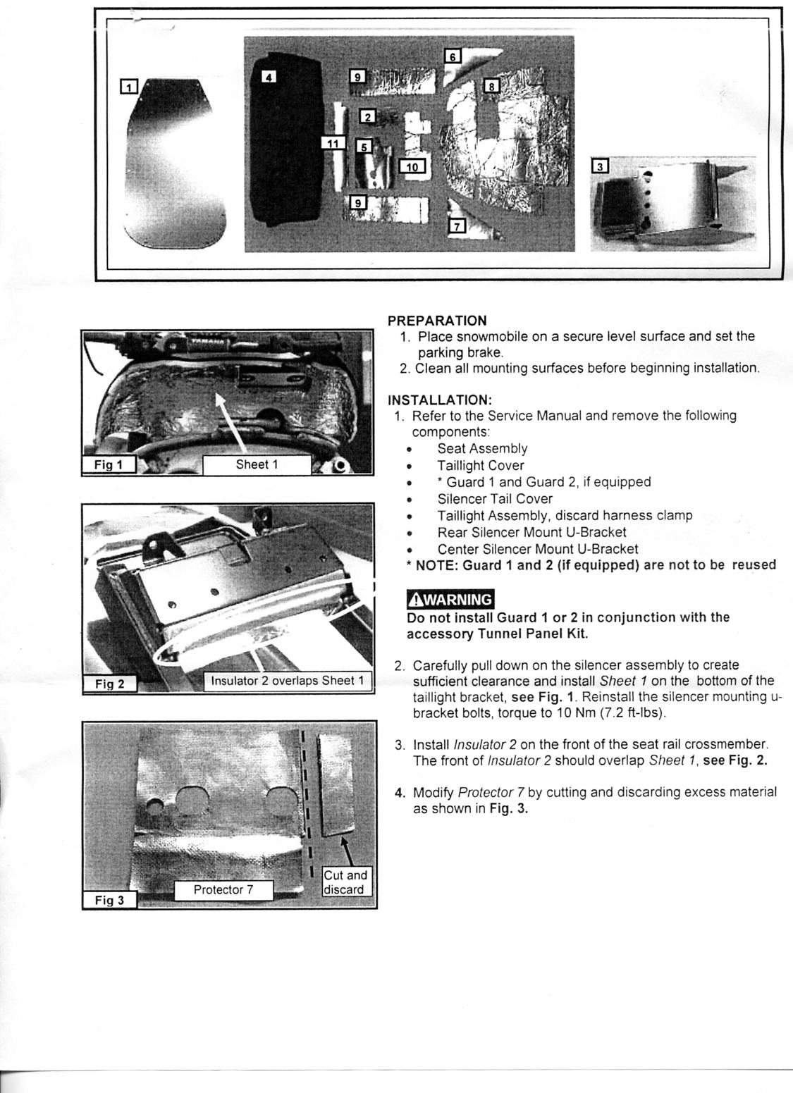

I picked up my tunnel close off kit at my local Yamaha dealer yesterday and noticed the lack of an installation instruction.
I'm just curious if any of you guys got an instruction with it?
Maybe it's self explanatory, i haven't had time to look at it yet.

Closing off the tunnel is easy without instructions. Fitting all the heat shielding pieces can be confusing. The instructions are sh!t anyway, you'll figure it out.
Alright, thanks. =)
What has to be removed then, tank, seat, exhaust?
/Rickard
/Rickard

i just took off the seat and rear plastic off, excell motorsport has instructions on how to install theirs on their site.. but its pretty straight forward.

all i did was cut some aluminum and rivit into my tunnel took about a hour
DeepFrz
07Nytro said:all i did was cut some aluminum and rivit into my tunnel took about a hour
Same here, was much cheaper than the kit and it worked well last season.
