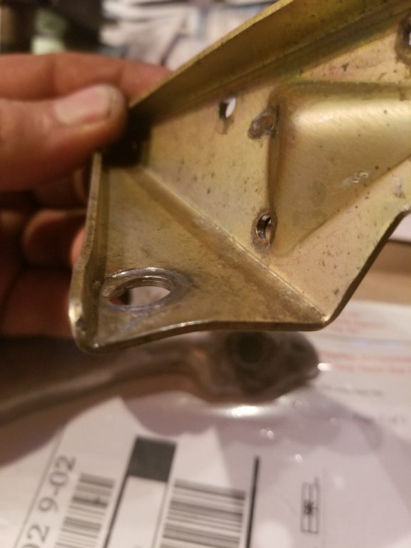

On the first ride up in Houghton, I ventured off trail down some logging road, prolly 3' of pow, the road kept getting narrower so I decided to throw a Chris Burandt move to turn around(tottal fail), burried the sled, so I tugged on the bars and ski to lay it on its side to pack some snow under the track, got out and rode to my riding group, once on trail I noticed my bar's were cocked to the left but skis were aligned perfectly, the bars weren't bent , neither was the riser block, I have the mtx steering conversion on mine. Once back home I continued to examine further, I put a bolt in the pivot arm and through the bottom of the sled to check alignment, ski's were pointing straight, tie rods were not bent, drag link straight also, bolt on the bottom of steering post was tight, steering support block also tight, bars and riser block not bent either, but the bars we're still cocked to the left a bit, I said to myself what gives, #*$&@ is not making sense, was driving me nut's.

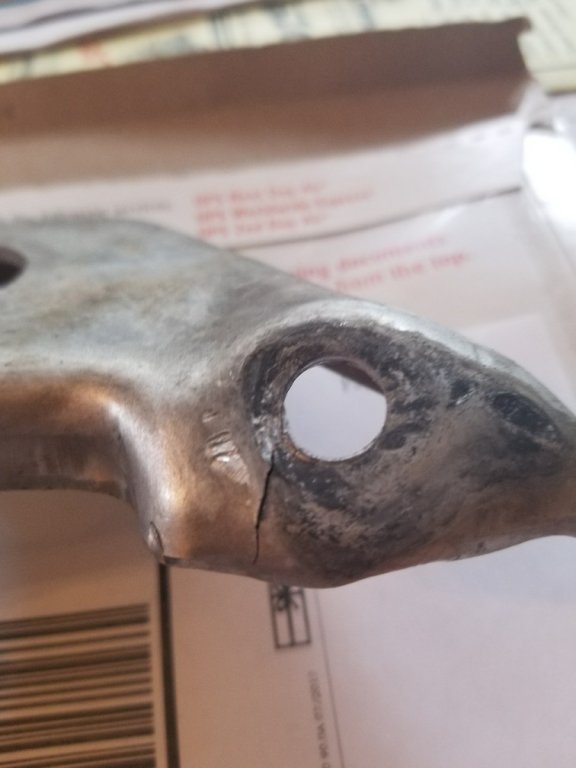

I tore the whole front end down, removed the radiator, removed front plastic clip, drilled out approximately 18 rivet's to remove the steering stop bracket and the aluminum support piece, turns out I bent both bracket's and cracked the aluminum piece that the bottom of the steering post bolts in to.
No big deal 4 days and $41 later I had 2 new bracket's and 20 black rivets, put er back together and all is straight again.

Thanks for calling customer service Murdered. They arent saying anything because this is a safety issue. Have seen way too many of this exact failure. I guarantee they will take note and hopefully a recall before someone gets hurt.
