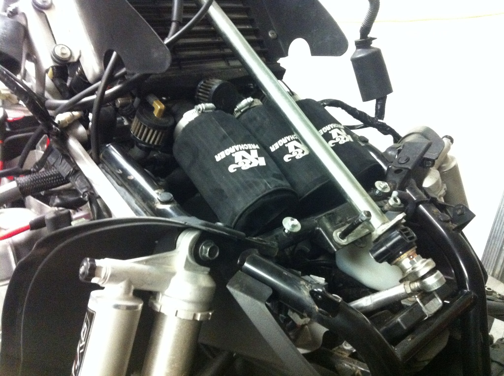

I had it on my Nytro XTX and it rocked. The K&N's are a pain, but they give it the huge bottom end boost. If you have a few extyra bucks get the autotune as well as its makes the sled run perfect.
DelgatyXTX
SledFreak said:I had it on my Nytro XTX and it rocked. The K&N's are a pain, but they give it the huge bottom end boost. If you have a few extyra bucks get the autotune as well as its makes the sled run perfect.
I agree. Easy to install in theory but try get your hands in there! I must have popped each air horn off the throttle body 3 times trying to get them all on last night. But now it's done! Leaves a TON of extra room on top of the engine now too.
Also, you don't have to take your bars off and move the steering post over. I just undid both the blocks and moved it over to the oil tank side a bit. Airbox was still tight but came out.

I have the same set up and love it....one word of caution...put additional support on the K&N's. I did this by adding a plastic tube from one side of my light assymbly to the other right above where the K&N's sit. I then secured them to this piece with velcro tape.
Found out about this the hard way when my ride was cut short last year after hitting a significant bump at speed and two of my filters popped off...not a good trail side repair at -35!

Yes, I added extra tie straps on mine to make sure they did not flex.
