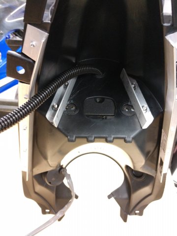

The gauge is off a 2012 Vector with EFI and EPS so it is the correct one. I figured out what the 8th wire was for the EPS error signal. It tells the gauge to illuminate the EPS symbol. Here are some semi finished pictures of my gauge swap. I added the aluminum bracing because the weight of the gauge and RAM mount made the plastic instrument panel flex way too much. I was afraid it would be hard to read on the trail and possibly break the plastic in the cold.

Great information. And I like what you are doing for the mounting.
