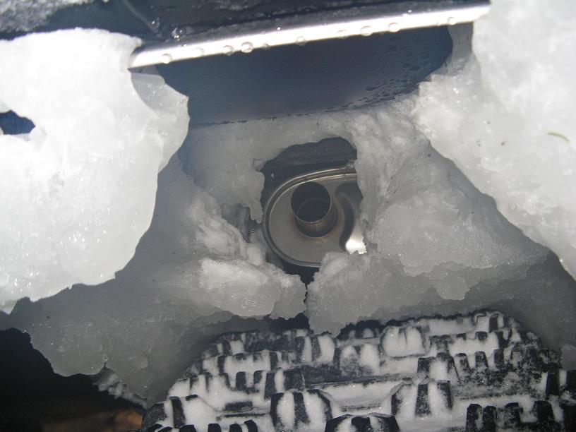

BombaPolaYama
The track wearing out that fast is ridiculous.
Yamaha should have replaced it under warranty. The snow/slush/ice build-up on these machines is unreal and a real annoyance. I get so much vibration and noise from the track/muffler/whatever on my VL (Venture heavy) when this happens it is unbearable. I would encourage everyone to write Yamaha and complain about this and send them pics to prove it. I have already written them (Canada) and they told me they are waiting feedback on improvements they made to the 08 model?? I am not familiar with the 07 but if it is worst than the 08, I wouldn't want to see it!
The issue of snow tunnel build-up and tippiness on cornering definitely takes the shine of this machine. Seems good otherwise.
I'm going to post pics later of the snow b'up. BTW, why isn't there a separate section fro VL and V Multi-purpose?

Some pics of the snow and slush build-up on my venture lite. You gotta love it. Did Yamaha even test these machines before putting them on the market?
Sorry, I posted one shot twice. I'm new to this so hope it works. Maybe others could post some pics as well.

GypsyRoots
- Oct 29, 2006
- 225
- 376
And you can see why I am arguing with Yamaha that they should warranty the track....
People here told me I just need to kick the ice off every once in a while.... HA! That would be every 5 to 7 minutes, and to remove all the ice, the MUFFLER HAS TO COME OFF!!!!
I just refuse to remove the muffler on the trail, it's ridiculous. I ride full tanks non stop often.
Big blocks of ice, fwd of the muffler, just sit there and rattle, rock & shake until they grind small enough to fit between the track and the heat exchanger.
And I can only imagine that the track on the MP is going to wear much faster, being 16 inches wide instead of the 15 on the VL. Topper had troubles with fraying early in the first season.
I believe my track is shot due to poor design/testing on Yamaha's part!
