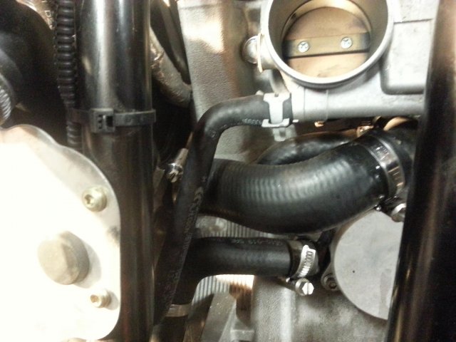

stingray719
HEY guys, I posted on this a while back. The hose that goes vertically into the thermostat housing has a trademark on the sealing surface! Ours did not leak until 500 miles or so and then was a bear to find. BUT, if your hose clamp is on just right it won't leak. Also seems to leak at random making it hard for the dealer to find. Had I known what I know now I would have just moved the hose clamp over closer to the end of the hose and retightened. Pic below should explain. Show pic to dealer if he is doubtful and ask him to check that hose.
