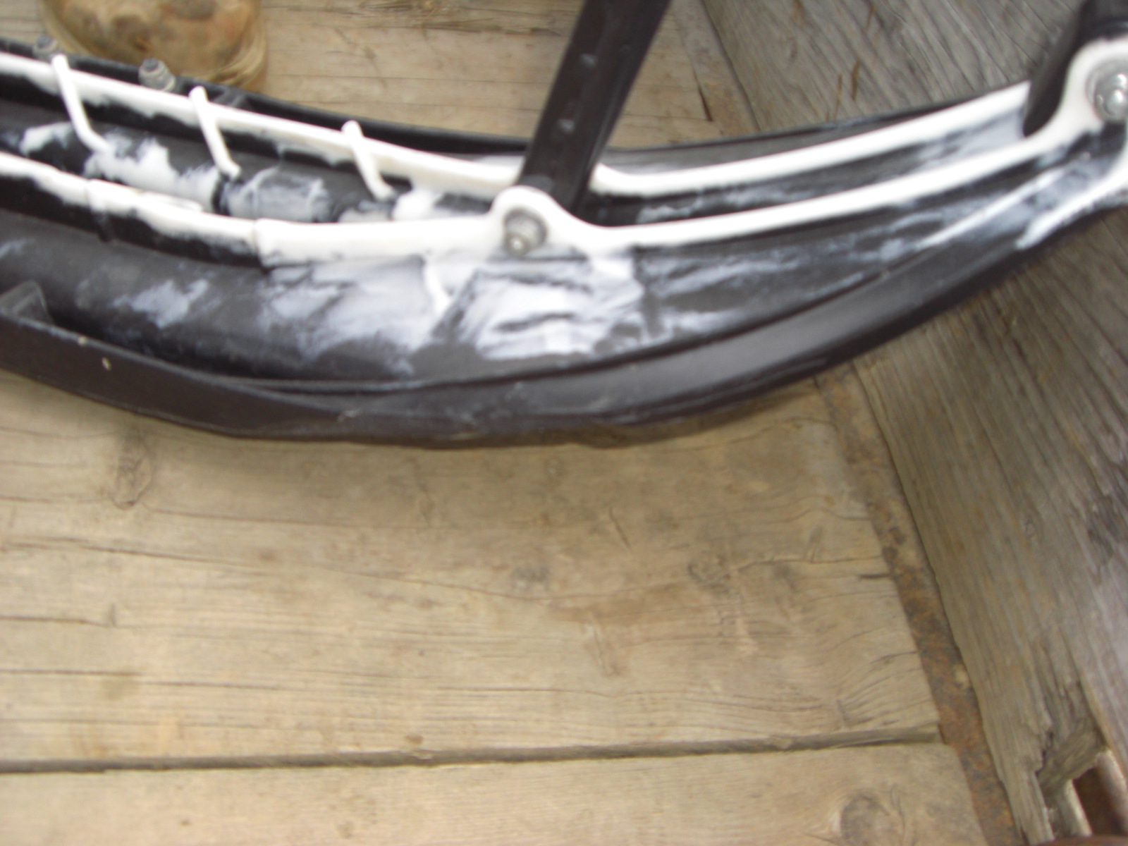

Plus if you have them look for bad donuts its about 130.00 if there not bad. I just took mine in for donuts and he said are you sure because warranty wont pay us to look. I already took it apart to look which is fairly quick and easy enough to do.How about any cracks in the rails?
Exhaust
W-arm
Transfer rod
Rails, good luck
W-arm
Transfer rod
Rails, good luck
