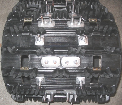

I am going to purchase a new 136 ripsaw pre drilled track.
Does anyone know what backers (type and amount) that I will need for that track, I probably will just go down the middle skipping any on the outside. I can't seem to find out the pattern anywhere I look. Also anyone know of a good place to buy these from, I think I am going to try to use the mega-bite studs. I would prefer a place where I can purchase the track and studs together (not required but preferred).

you can do 108 or 162 up the center.i can sell you the track and studs and even pre install the studs for $20 extra if you like.you can use all single backers or all double backers with the 108 pattern.otherwise if you want to do the 162 you have to use single's and doubles.You will have to buy either 120 or 168 since they come in packs of 24,96,144 only.The mega bites come with tall nuts now.I can get any stud,backer combo.Depends on what you want to spend and if your set on any brand.Heres a ripsaw that i sell pre-studded.I used extreme max studs in this one.Any questions let me know.rich

Can you send back a price with shipping for the setup you had shown, the pattern is pretty much what I was looking for. Again the track that I was looking for was 9969H162 (136 Rip saw pre-drilled and fully clipped); if the install is 20 bucks then you might as well figure that in there also. The extreme max studs should also be ok.

sorry i got side tracked friday and forgot to finish my reply to you.heres some info.i priced it with mega bites and extreme max like in pic.any questions let me know.thanks rich
track=$485
168 mega bites=$252
72 single woody backers=$36 ( you only need 54 but they are sold in 24 packs)
72 double woody backer=$57.60 ( again you only need 54 but sold in 24 packs)
total=$830.60 plus $20 install=$850.60 + s/h $30=$880.60
168 extreme max=$201.60
54 extreme single=$16.20 ( i have these in bulk )
54 extreme double=$32.40 ( same as above)
total=$735.20 + install=$20 + s/h $30=$785.20 total
