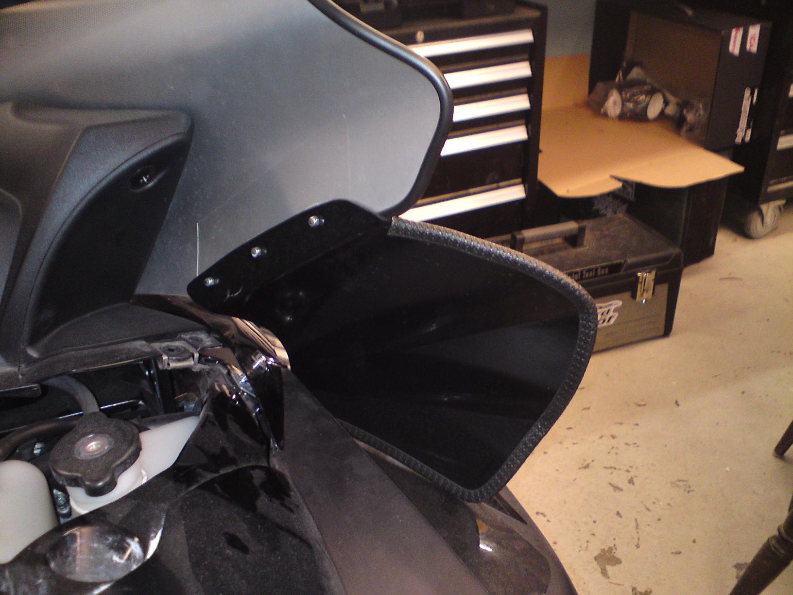

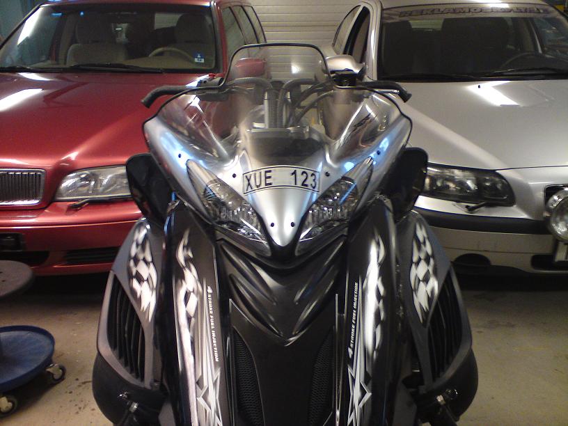

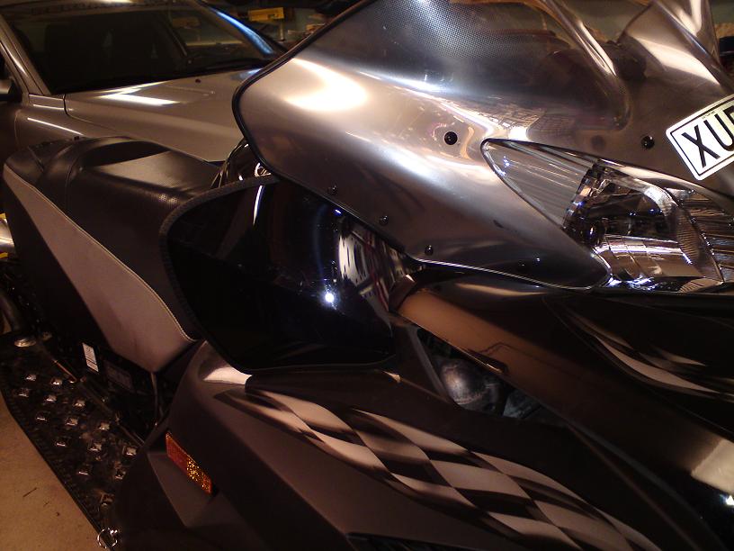

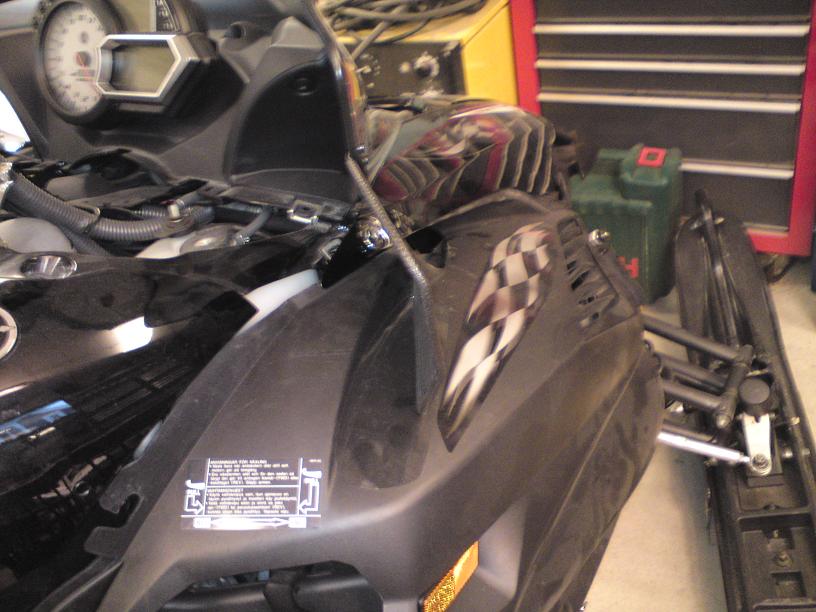

Here are the photos:
I cold bended the lexan in a simple sheet metal bender.
It got half an inch of play to the hood, so it can be removed.
I put som "rockguard" protection vinyl on the side panels and windshield, but there is no sign of wear.
I scotchbrite the backside and painted them black with RC body paint.
Best regards Richard Malmlöf
